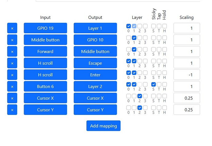

GPIO 19 is used to indicate whether a particular program (FreeCAD) has input focus.
This is used to customise some of the buttons specifically for FreeCAD and a couple of them for any application.
The problem here is that “Button 6 - Layer 2” assignment, ONLY works when FreeCAD doesn’t have input focus, i.e. Layer 1 is not active.
Activating the cursor slowdown (the last two entries) when FreeCAD does not have focus, does as expected and allows movement of the cursor with greater precision.
If I then give FreeCAD input focus, that precision remains until I click Button 6. That switches it off, but will not switch it on again.
I have no idea how to make this work properly.
Any clues?

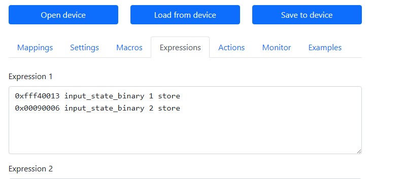

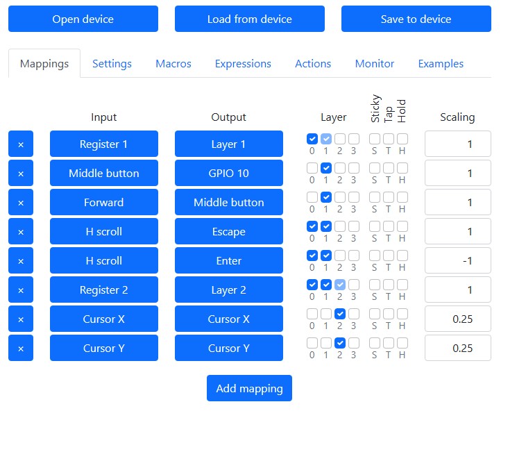

Update on my question.
I’ve changed the mappings slightly, but it has made no difference.
0xfff40013 is GPIO19
0x00090006 is BUTTON6
When GPIO19 is high (1) pressing and holding BUTTON6 has the desired effect of slowing down the mouse cursor.
When GPIO19 is low (1) button 6 has no effect.

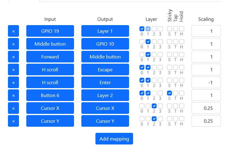

This is exactly the same outcome as the previous simple assignment of
GPIO19 - layer 1
BUTTON6 - layer 2
It would appear that Layer 1 being active precludes Layer 2 being active.

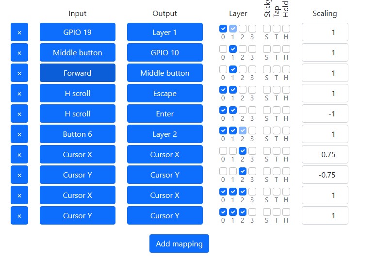

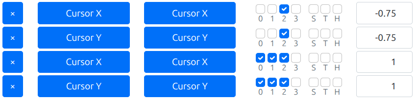

You can try something like this:
I’ve given that a try, the cursor slowdown only works when layer 1 is active.
I had started writing some expression stuff to try to get the right scaling…
My mistake, I didn’t have Button6 enable in all layers.
Works a treat now. here’s what it looks like, there are no expressions or macros.
