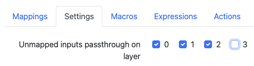

Finally, you must uncheck ‘Unmapped inputs passthrough on layer’ for your mouse layer (I’m using layer 3 here as an example.) This stops the z, x, left-shift and arrow keys from mapping through as they’re being used inside the expression.
Note: You can’t simply map them to ‘Nothing’ as that also prevents the expression engine from parsing them. Hopefully this will change in the future so you can use mouse functions on layers with other active items.
