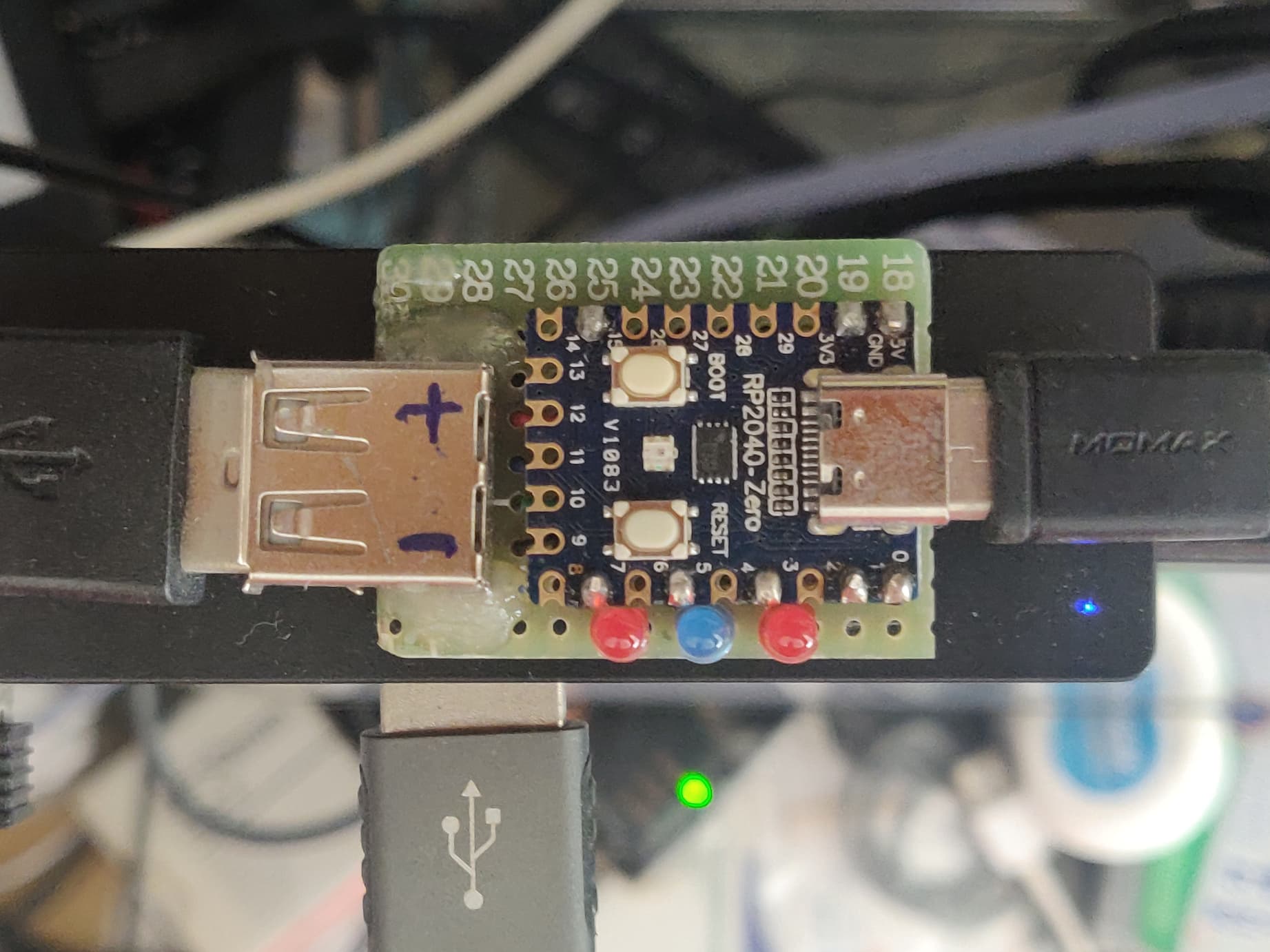

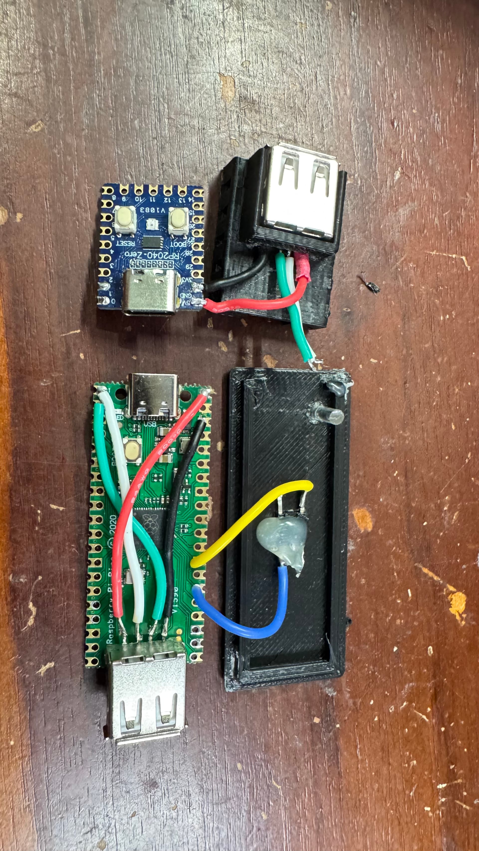

My connection:
USB (Femnale) | PICO
5V | 5V
D- (Blue) | GPIO 1
D+ (Green) | GPIO 0
Gnd | Gnd
| GPIO 2 --LED >|—330ohm–Gnd
| GPIO 3
| GPIO 4 --LED >|—330ohm–Gnd
| GPIO 5
| GPIO 6 --LED >|—330ohm–Gnd
Yes I succesfully flashed, I can see the device on the configurator.
this is the connection diagram on the board. I checked and not shorts.
When I say nothing happen is that mouse or keyboard connected to it is dead, no lights no power and also not actions at all, monitor shows not activity.

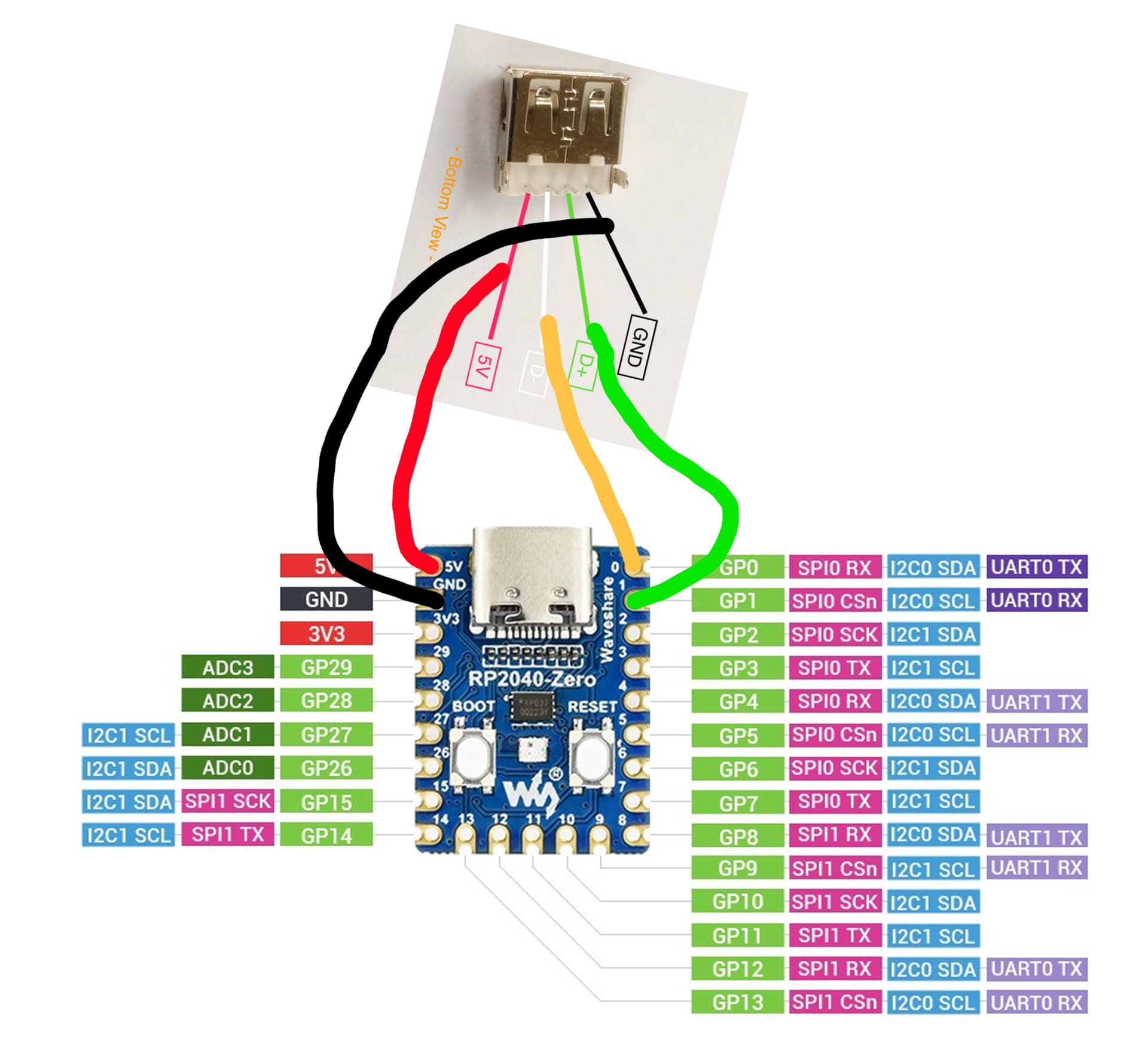

D+ should be wired to GPIO0, D- to GPIO1.
It is working now, that switch make the trick.
