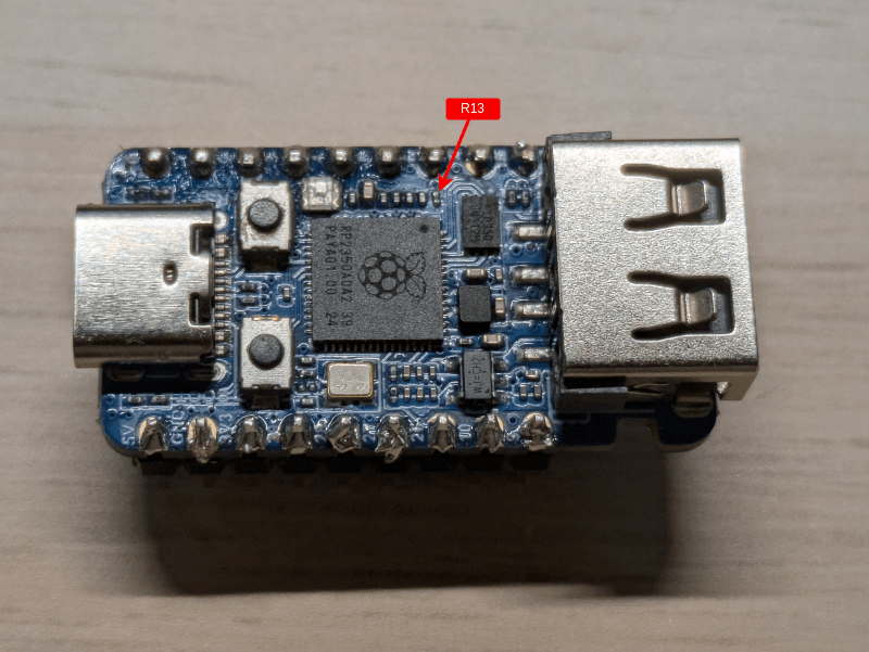

I usually respond that it might work for you (and we do have a firmware build for it), but I don’t recommend it because its designers made a questionable decision to put a pull-up resistor on the D+ line of the extra USB port. This was presumably done to make the port usable in device mode, but it has sabotaged its primary function (host mode).
The RP2040-PiZero board has similar issues.
Here’s a more detailed explanation with the resistor in question identified. If you’re brave enough you can try desoldering it, though the part is tiny.
