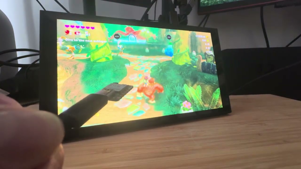

This change adds roll, pitch and shake support to the HID Remapper, enabling the Xiao BLE Sense IMU data as input sources. You can now:
  • Control games with your feets on a balance board — similar to a 3D Rudder
  • Add tilt‐ and shake‐based control to the Xbox Adaptive Controller and Adaptive joystick
  • Trigger clicks via a quick tap (using shake threshold)

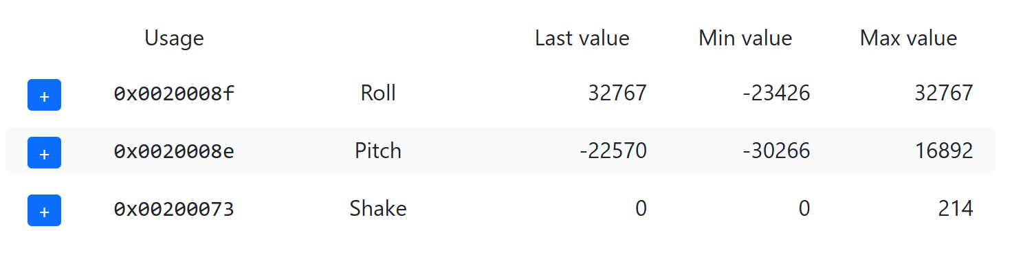

New Inputs
  • Roll (X axis)
  • Pitch (Y axis)
  • Shake

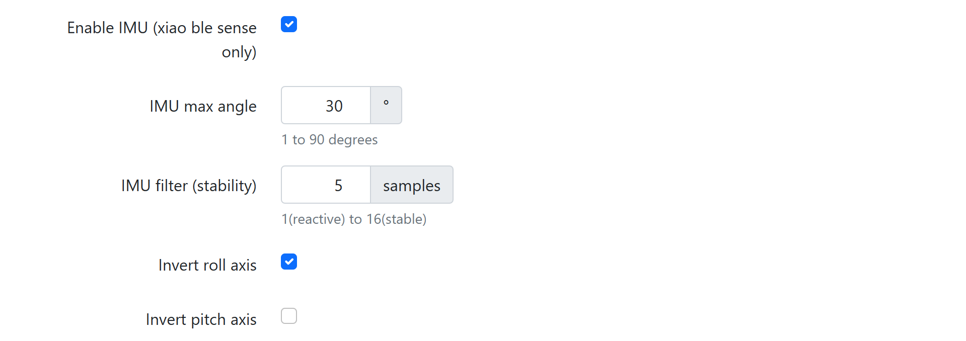

Configuration
  1. Enable IMU
    Go to the “Settings” tab and toggle on IMU support.
  2. Adjust parameters
    • Angle limit: Clamp maximum tilt angle
    • Buffer size: Smooth incoming data to reduce jitter
    • Axis inversion: Easy axis change without using expressions
