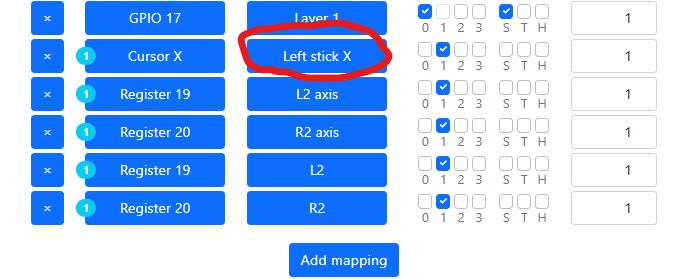

Jacek sent me this update (thank you!). Try this out. Works brilliantly for me. Use the GPIO17 port (aka WALK/CREATE/CAPTURE/SHARE) switch socket to switch between the default left-stick mode in port 1 (“L”) and it acting like L2/R2 in analogue fashion.
Hi when I tap 1 time on Shift I can’t do anything with joystick, but I can Shift back to left-stick mode
Try this version. I forgot an odd quirk that needs the L2/R2 button pressed as well as L2-axis/R2-axis activated. Have now tried on a PS5 with the Brook adapter. Seems perfect my side.
CATCH 22 - SWAP STICK TO R2-L2 (via GPIO17 SHIFT) (PS5).json (33.8 KB)
Hi now I gas and break but no stearing, I can Shift in and out
You may need to unplug / replug the Zik-Zak into Port 1 (“L”) for it to work…. Or wait for the set-up to connect, then plug in the Dualsense into Port 4 (“help”). There seems to be a slight timing issue there. Wonder if this is a small bug in the HID Remapper code / something that can be tweaked and improved.
Ah, I don’t remember you asking for steering as well.
CATCH 22 - SWAP STICK VERSION (L-STICK_DRIVE) (PS5).json (33.8 KB)

When I driving full throttle is just after I press the joystick half way
. How can I fix that?
