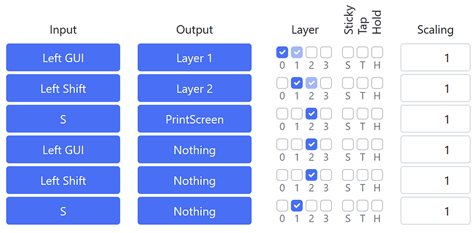

I’m looking for a way to catch a key combination and replace it. The idea is to catch Win+Shift+S and replace it with PrintScreen. I created something with two layers, which at least caught this and sends the PrintScreen, but it also sends a single S at the same time - which shouldn’t happen. Anyone has an idea?
The S is probably sent when you release the modifier keys before you release S and it goes back to the lower layers.
Thank you very much! You are right. I added another mapping and now it works:
