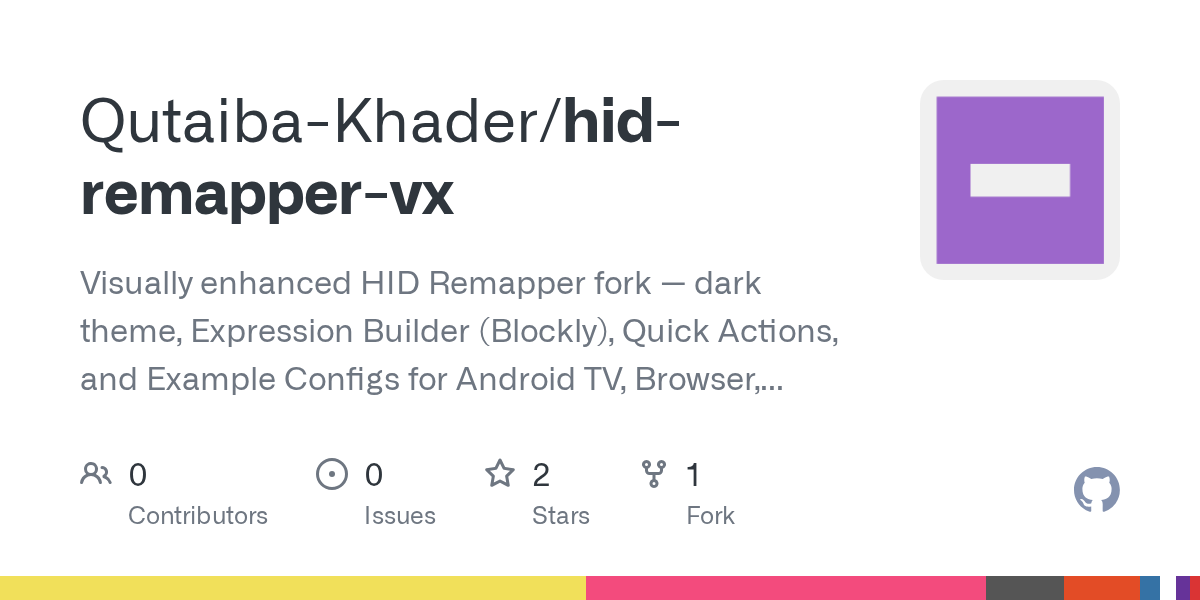

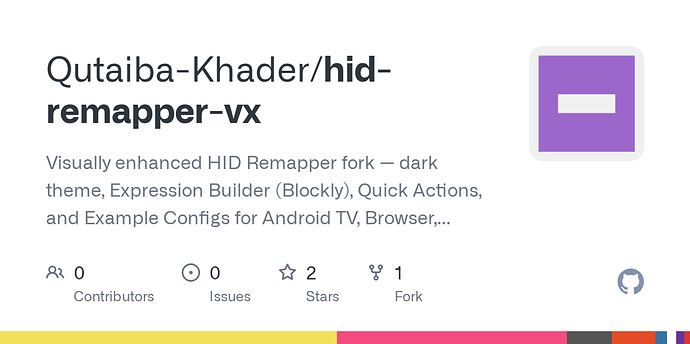

Check this, I’m trying to redesign the ui, add an issue if something needed
