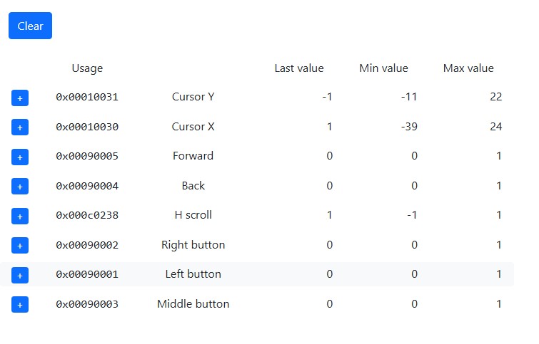

I saw your Wireshark video while you were posting! As shown in the screenshot, the first 8 buttons are all monitorable and therefore assignable.
Here’s the capture which includes the 9th button (don’t ask me which entry, I have no idea!)
