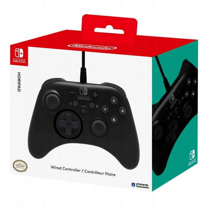

Got it working nicely using the HoriPad descriptor; thanks again for your guidance! I really like this format since it’s so simple: no motion controls, digital instead of analog triggers, etc. What model/SKU HoriPad is it? Thinking of buying one to do a little reverse engineering myself.
It’s this thing. Model number is NSW-001U I believe.
