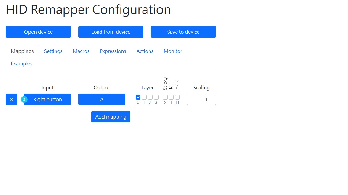

I config USB hub port 3 : Right button to something, then every port 's right button not working.
That’s how “Unmapped inputs passthrough” works. When an input is mapped to something on any port then it’s considered to be mapped and passthrough doesn’t apply to it, even on the other ports. You just need to explicitly map the right button to the right button on the other ports.
