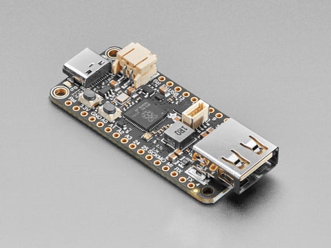

If you have a soldering iron just get a Pico or a Waveshare RP2040 Zero and make it yourself. Otherwise the Adafruit Feather board is a safe bet, all the Waveshare boards with a host port have the unnecessary resistors (though the RP2350 ones only have one on the D+ line, which is better than having them on both maybe?). But like I said, they should still work to a degree, so I don’t know why you’re not getting any inputs at all.
I’ll return the board then, but before doing that, could you tell me the exact Adafruit Feather board model so i can buy it?, thanks.
Alright, one last thing, after i get this board. which firmware should i flash into it? is it remapper_adafruit_feather_nrf52840.uf2 ?
No, that’s the Bluetooth one. You want remapper_feather.uf2.
