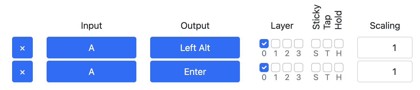

With mappings like these the A key will send the Alt and Enter keys simultaneously:

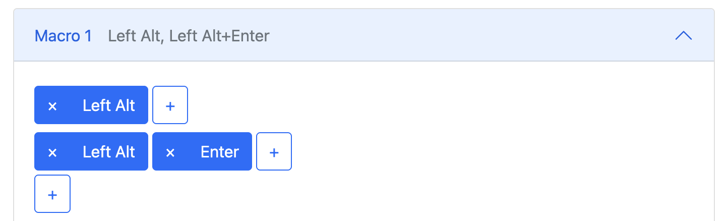

If it’s important that Alt is pressed before Enter then you can use a macro:
Post the configuration you’re using if you’re still having trouble getting it to work.

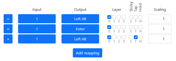

Neither of your suggestions worked, however it got me to try a few similar configurations and this one works although not entirely intuitive: Thank you so much for your help, greatly appreciated.
That suggests it matters that Alt is released after Enter. You can of course also do it with a macro.
And yes, that also works.
