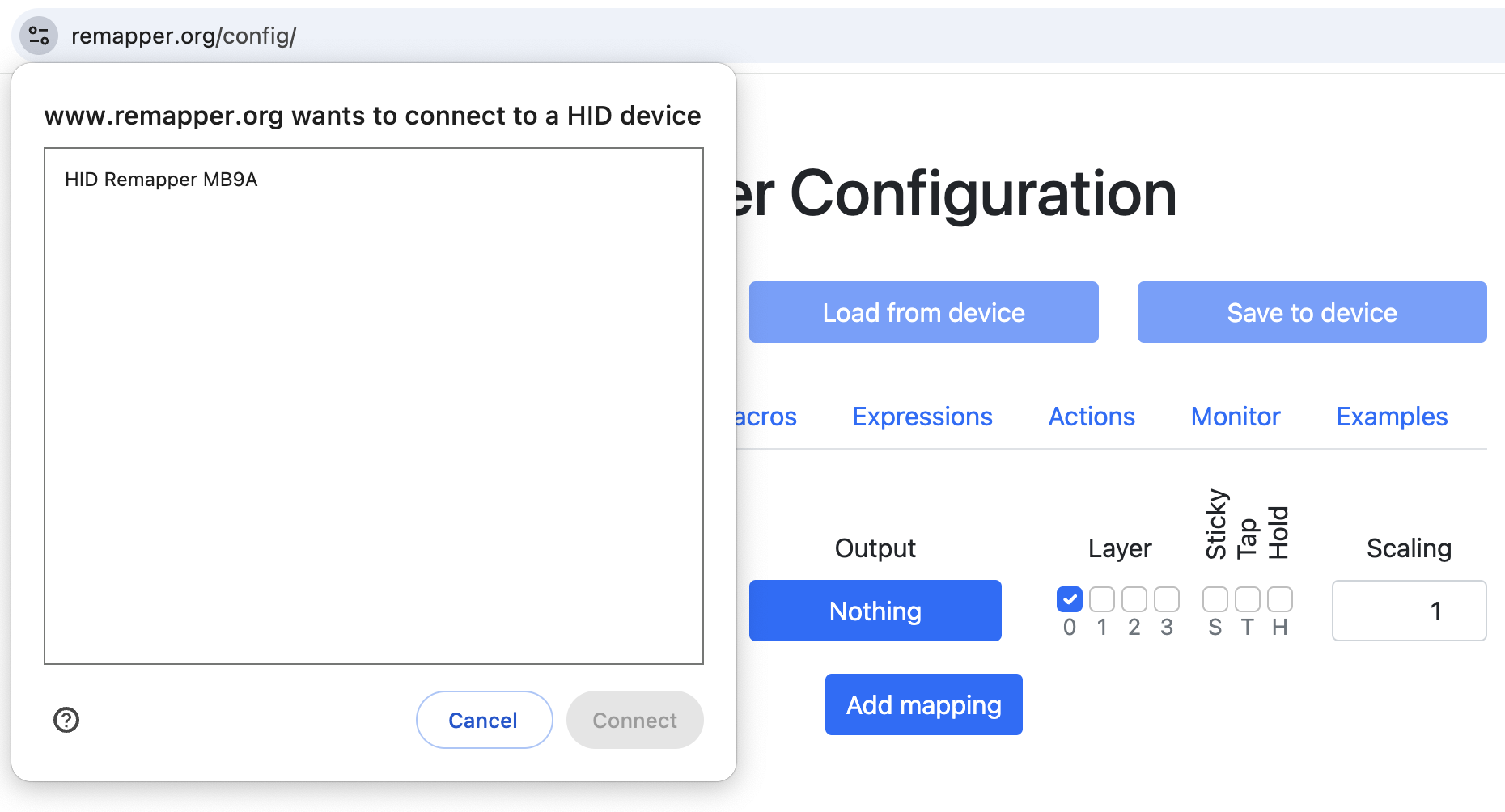

The configuration website uses WebHID.
When you click “Open device”, it presents you with a list of devices. You select the one you want and click “Connect”. This is when you give permission to the website to talk to your device.
