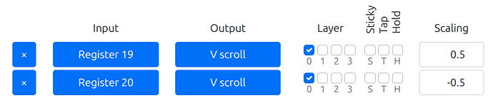

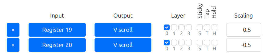

Then you can just map the result to “V scroll”:
For POOLS specifically I noticed that it stops working when scaling goes below 0.5. So if you want to change sensitivity you can change the interval in the expression. As is it sends a half tick every 100ms. If you make the interval lower or higher it will send the same amount of scroll, just more or less often. If other games still don’t like the half tick, you can set scaling to 1 and adjust the interval to taste, effectively making it work like a normal “low resolution scroll” mouse.
This expression isn’t perfect in that it looks at the wall clock and sends the tick on fixed intervals, so it’s possible to press and release the button quickly without sending a tick at all, if you’re unlucky. Ideally it would send the first tick on button press and then another one 100ms (or whatever) from that moment, but it would be a slightly more complex expression.
