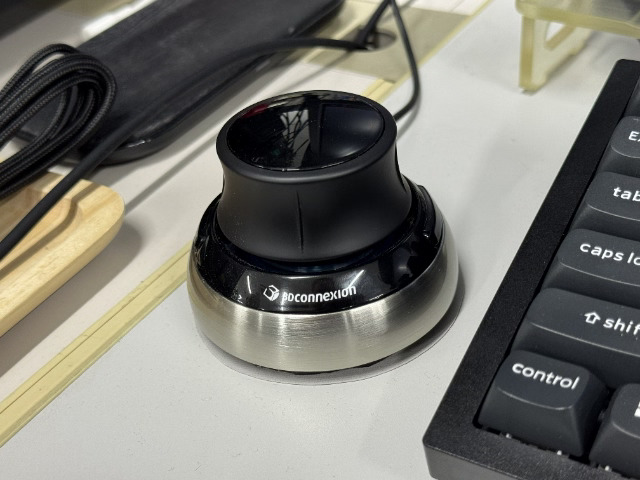

I would like to remap the SpaceMouse Compact.
This device is mainly used for CAD.

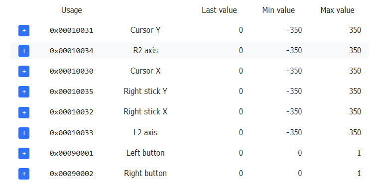

I am using Custom-boards v1 and have flashed remapper_board.uf2.
Since there is no equivalent of an “Emulated device type,” this is expected, but what kind of information would be required in order to support this device?
Thank you in advance.
You want it to still work as a spacemouse afterwards? This isn’t currently supported. Anything you want to achieve that isn’t possible in 3Dconnexion’s software?

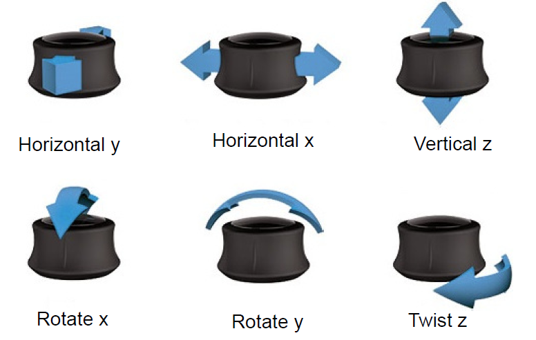

The 3Dconnexion software does not have the following settings:
  • Swapping Horizontal X (10030) and Horizontal Y (10031)
  • Swapping Rotate X (10033) and Rotate Y (10034)
I have submitted a request to 3Dconnexion, but I have not received any response.
