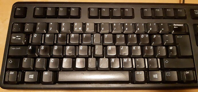

into this:
As you can see, it achieves two main things:
1 – it moves the nicely-angled right-hand side over a bit in the style of a split keyboard - even having the hands just a couple of centimetres further apart makes a big difference to my shoulders, elbows, thumbs and right little finger.
2 - it corrects the wrist-breaking angle that one is supposedly expected to maintain on the left-hand side.
Keycaps are from an old laptop, with one side cut off in places so that they extend slightly over the neighbouring keys:
(a photo showing the shape of the laptop keytops showing how they fit with respect to the original keys)
I tried using Autohotkey but it seemed rather laggy and it missed keystrokes when typing quickly. I tried a custom keyboard using MSKLC but the control keys didn’t map as expected. HIDremapper seems to work perfectly (so far)!
I made the mapping table by semi-manually editing the .JSON file using a spreadsheet - this was much easier than I expected.
Maybe at some point I’ll use the keys between the thumbs as layer keys, but I’m very happy with it so far.
Thanks again

My original keyboard layout was this:
     1   2   3   4   5   6   7   8   9   0   -   =
       Q   W   E   R   T   Y   U   I   O   P   [   ]
        A   S   D   F   G   H   J   K   L   ;   '   #
      \   Z   X   C   V   B   N   M   ,   .   /
I remapped the keys like this:
     #   1   2   3   4   5   6   7   8   9   0   =
       Q   W   E   R   T   [   Y   U   I   O   P   -
        A   S   D   F   G   ]   H   J   K   L   ;   '
      Z   X   C   V   B   \   /   N   M   ,   .
Then I stuck laptop keycaps on top of the existing keys (with keys 67890- and QWERT offset 0.25u to the right, ASDFG and /NM,. offset 0.25u to the left) to make them look like this:
     #   1   2   3   4   5    6   7   8   9   0   =     ->
->      Q   W   E   R   T  [   Y   U   I   O   P   -
<-     A   S   D   F   G    ]   H   J   K   L   ;   '
      Z   X   C   V   B   \  /   N   M   ,   .          <-
– and I have a quick and cheap and easy (and easily duplicated) ergonomic keyboard, with function keys, numeric keypad, etc (which I still use).
Yeah, it took me a minute to understand how you inverted the stagger on the left half!
