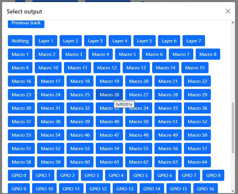

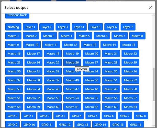

My local copy of the web config has editable macros up to 64:
And I can choose from them in the output page:

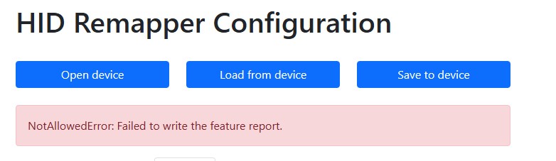

but when I try to ‘save to device’
at that point the ‘A’ pico stops responding, no keys pass through at all and comunucation with config is not possible until the pico is powered off and on again.
Maybe it’s breaking trying to read the config from flash because the number of macros changed and it’s getting garbage. Normally it’s handled by versioning the config but you can try clearing the existing config by flashing this:
https://datasheets.raspberrypi.com/soft/flash_nuke.uf2
and then try your build again.

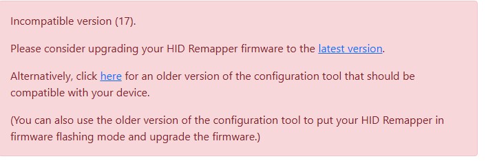

This just leaves this problem.
Please can you advise how to fix this?
Thanks.
Cancel that, I changed the version number to suit in code.js
const CONFIG_VERSION = 17;

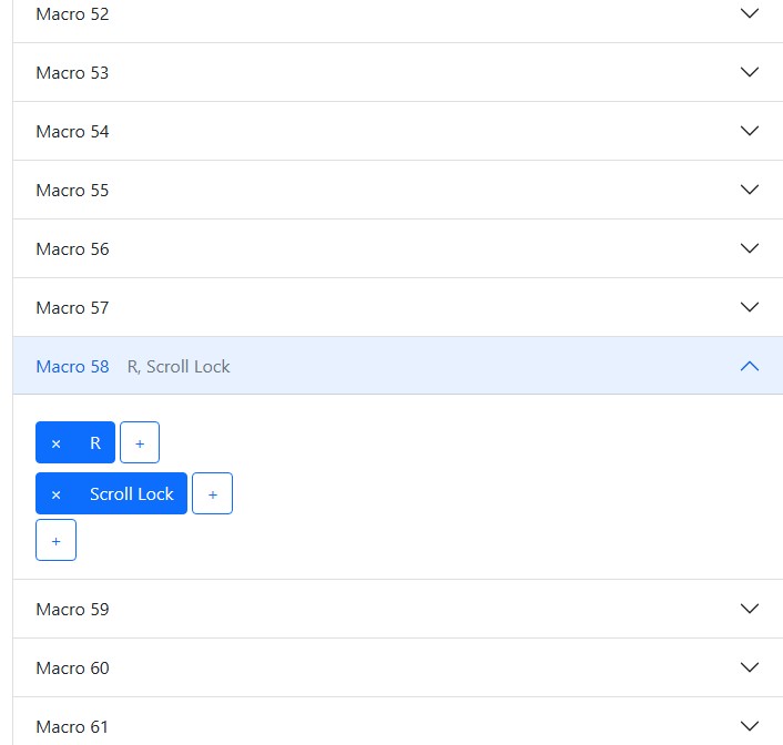

I can create mappings to macros up to 64 (this was an arbitary choice just to try this out, I hope to have more than that when (if!) this can be made to work.
I can create macros up to 64.
These changes can be saved to the device, loaded from the device and saved and loaded to and from disk.

in usages.js
"0xfff2001f": { 'name': 'Macro 31', 'class': 'other' },
"0xfff20020": { 'name': 'Macro 32', 'class': 'other' },
"0xfff20021": { 'name': 'Macro 33', 'class': 'other' },
"0xfff20022": { 'name': 'Macro 34', 'class': 'other' },
"0xfff20023": { 'name': 'Macro 35', 'class': 'other' },
"0xfff20024": { 'name': 'Macro 36', 'class': 'other' },
"0xfff20025": { 'name': 'Macro 37', 'class': 'other' },
"0xfff20026": { 'name': 'Macro 38', 'class': 'other' },
"0xfff20028": { 'name': 'Macro 39', 'class': 'other' },
"0xfff20029": { 'name': 'Macro 49', 'class': 'other' },
"0xfff2002a": { 'name': 'Macro 50', 'class': 'other' },
I continued the sequence after Macro 32 as above.
Where should I be looking in the firmware source ?
Of course, on closer inspection, I skipped 0xfff20027 in the table above. Now that I have corrected that, I have it all working.
