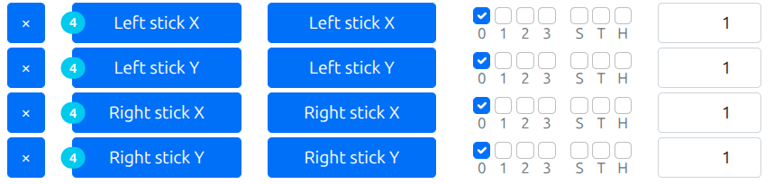

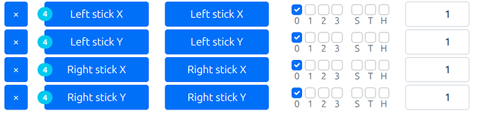

I need to look into it, because it’s not behaving quite the way I expected it to, but you can definitely make it work by adding explicit mappings for the sticks like so:
Note that the hub port is set on these mappings, you will need to set it to the hub port matching the one you have your controller plugged into (you can check in the Monitor tab).
(“Left stick X/Y” may show up as “Cursor X/Y” on the input side, they are the same thing.)

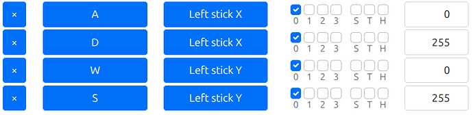

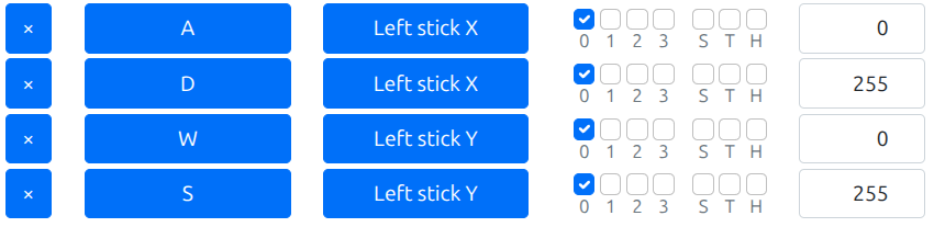

Also you can map keyboard keys to analog stick positions without using expressions, like this:
Note the scaling parameter is set to 0/255.
This isn’t quite equivalent to the expressions (the expressions result in a circular motion), but maybe it doesn’t matter for your use case.
