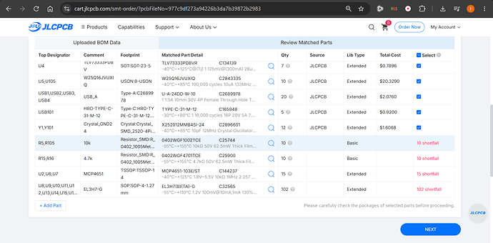

I attempted to order some v6 and v7 boards from JLCPCB but they’re out of some of the necessary components. Are there alternative components I can point the system to in order to proceed with the order?

The resistors are very common and generic parts and can be replaced by anything with the same package and value, but these specifically save you $3 per component type because they’re “basic” parts and JLC has them already loaded on the machine. I see that they’re in stock right now.
I don’t know of a drop in replacement for the digital potentiometer, but you can preorder it at JLCPCB and they will get them for you.
I see that the optocoupler can’t be preordered but it should be easier to find a drop in replacement for it. VOS617A-7T (C190671) or LTV-356T-A (C17565970) may work and can be preordered. Check the orientation of the part because sometimes on JLCPCB even parts with the same package have a different default orientation on the footprint.

Thank you for the heads-up! I tried ordering just last night (EST-US) and the screen shot of the v7 I included was the result.
I was able to complete and save the v6 order in my account for later processing. Hopefully this means they’re in the process of restocking the components necessary to build the v7 boards. I just tried the order process while typing this reply and it looks like all that is missing is the DIP potentiometers and phototransistors. I’ll hold off a little longer and try the v7 order in the near future.
