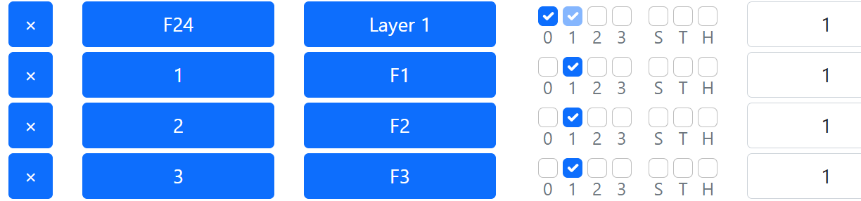

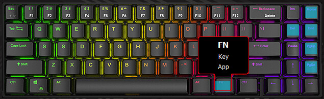

But if you’re using factory firmware, you can connect the keyboard directly to PC first, then remap the fn key to something like “F24” using factory software. If your firmware doesn’t support F13-F24 use other key like “Pause”, “Scroll Lock” or somthing. Like this
Then reconnect the keyboard to the pico and remap the “F24” to something that you want (e.g changing the layer).
{E37410D4-962A-4578-A509-BE8F5D702B62}

You need to implement all fn key functionality from factory firmware, for example in my 65% keyboard:
Fn+1 → F1,
Fn+2 → F2 etc.
Because you don’t have any fn key functionality anymore. Your mapping should looks like this
when in layer0, button 1 sends “1”, and when in layer1, button 1 will send “F1”
