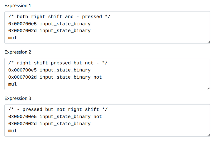

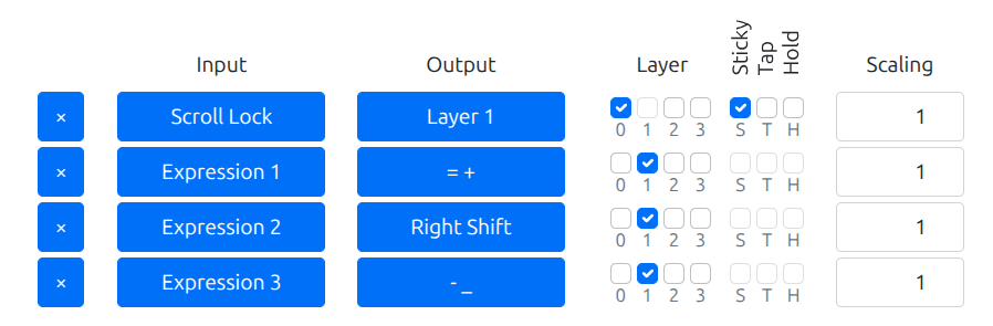

You could do it with a configuration like this:
hid-remapper-config-1.json (2.6 KB)
Worked! Thank you so much.
