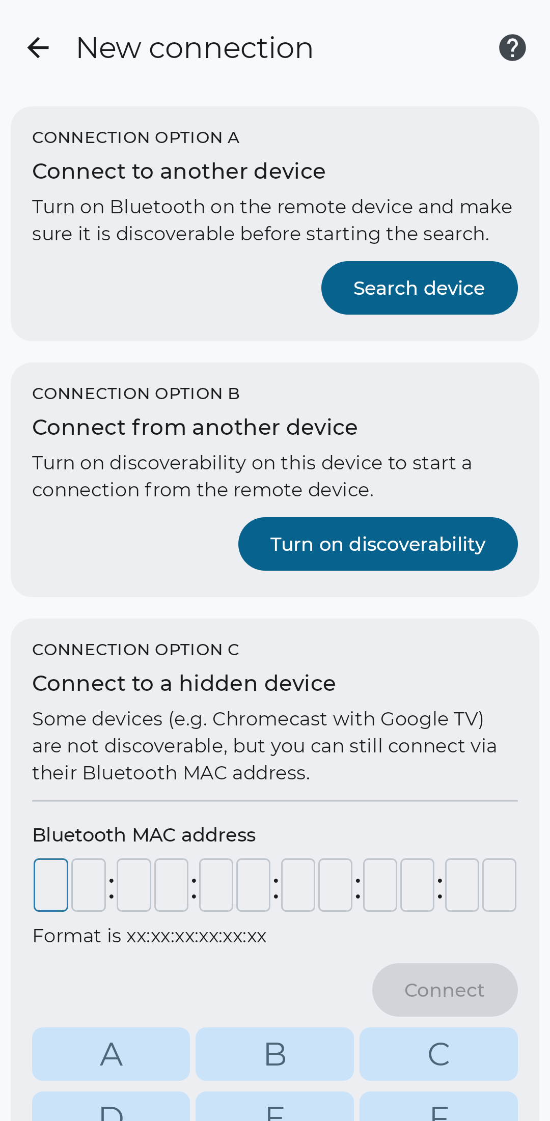

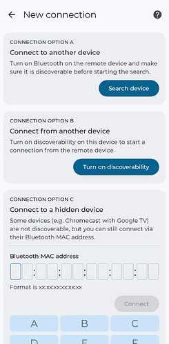

None of that is necessary. I literally just typed “bluetooth keyboard” in the Play Store search box and installed the first app that pops up. It was this one:
When pairing with a new device it gives you the following options:
Both option A and option B work just fine without messing with any additional apps. Just follow the instructions. If you choose option A, go into Bluetooth settings on the other device to make it discoverable (it will say something like “Visible as X to other devices”), then select it on the device with the keyboard app on it and confirm the pairing on both devices. If you choose option B, go into Bluetooth settings on the other device, tap “Pair new device”, select the device that has the keyboard app on it, confirm the pairing and that’s it. Option B looks exactly the same as when you connect an actual physical Bluetooth keyboard to your phone.
That’s one of the apps I’ve been trying to get working! There are others, but this one is clean & well designed, and can be configured as keyboard only (no mouse/trackpad wasting valuable screen space).
My primary phone, used for testing, does not have any option to make it visible (Samsung S10, Android 12). I just checked again. The current secondary (LG V20, Android 7.0) doesn’t have this option in settings, but I just noticed some tiny print which says it’s visible while the Bluetooth settings page is onscreen – a no-option option! I really appreciate your reply, but the main issue is I’m using older hardware, and these BT options are either not obvious (V20) or unavailable (S10). With even older hardware I expect the exposed settings to be even less helpful.
