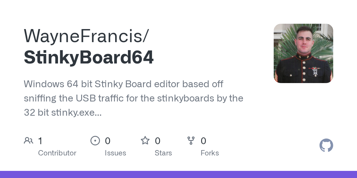

The boards currently just report ad a keyboard. I’ve written a 64 bit windows app to allow setting the keys like the current window 32 bit app does. I’ve reverse engineered the USB traffic. If anyone is interested here is the github repo. I’m looking into adding features, hopefully multi-key macros, but that looks like I’ll have to write a custom firmware at this point.
