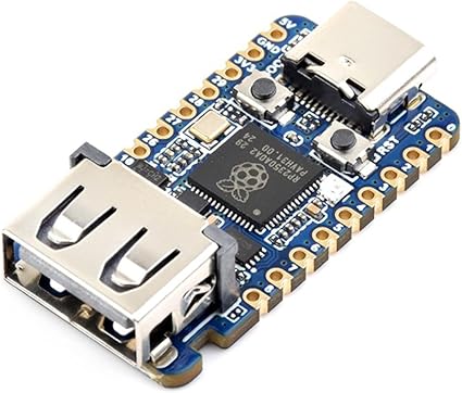

Please check can this work also ??
Adafruit international delivery Charges are too much i only find this in my country can you please tell me if this one works or not with HID Remapper
RP2350A USB Mini Development Board, Official RP2350A Dual-Core & Dual-Architecture Microcontroller, 150MHz Operating Frequency, Onboard USB Type-A and USB Type-C Port,15 x Multi-Function GPIO Pins
This is the product name
Yes, we have a build for that board too, though it has an unnecessary pull-up resistor on the USB data line so I don’t normally recommend it. You may run into issues with some devices.
Bro I only found this in my region hopefully it will work thankyou for your precious time <3
