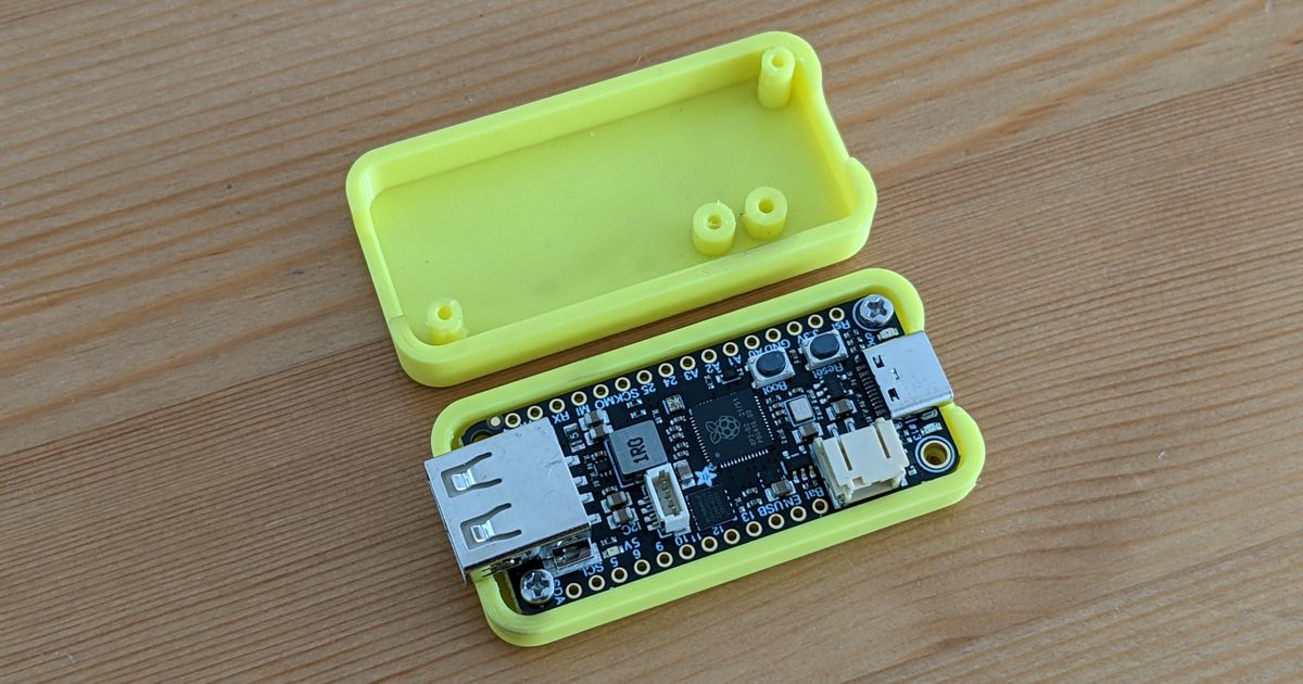

Only other thing to ask is whether anyone has found any cheap casings or else 3D printable designs that I could house it in?
Again thanks for the help and suggestions :slight_smile:
I made a case for the Feather board if that’s what you’re using:
yes that looks perfect - thank you :ok_hand:
