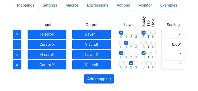

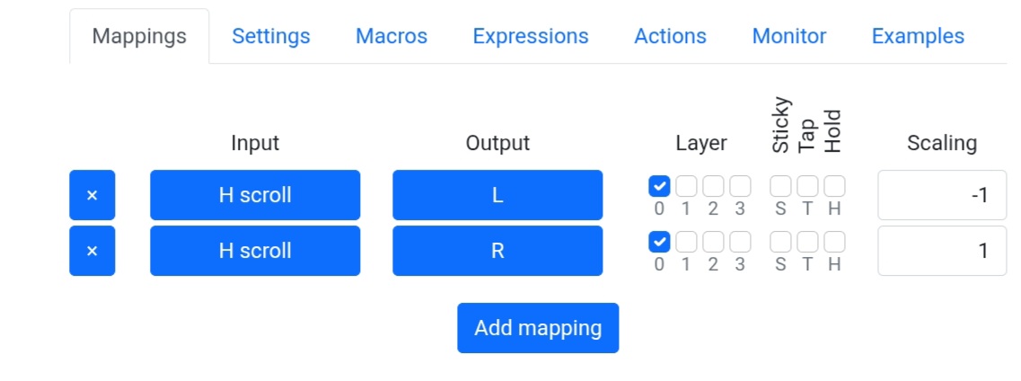

I want to remap the left H scroll and right H scroll to different layers with different drag scroll speeds, but it seems to remap only to the layer with the faster scrolling. When I remap the H scroll to different keystrokes, it works fine, but not with the different layers.

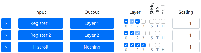

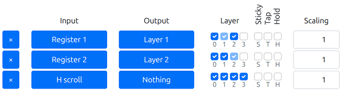

and map Register 1 to Layer 1 and Register 2 to Layer 2:
This will toggle them independently, meaning both layers can be active at the same time and activating one does not deactivate the other, which might not be what you want.
Here’s an expression that will deactivate Layer 1 when Layer 2 is activated and vice versa:
